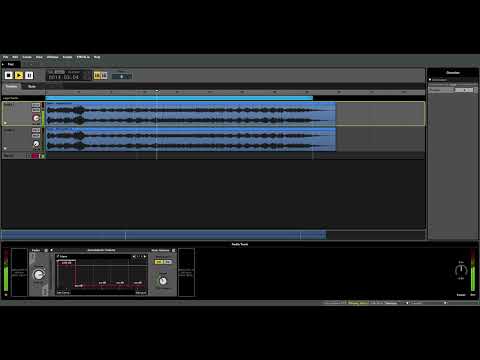

In this exemple, I switch between two identical items, to highlight the volume ramp problem:

I already mentioned that in my first post, but that’s a poor workaround. The 4th exemple in the video above uses an upward value of 0.5 and downward value of 0.15 ; it’s better but far from ideal.
