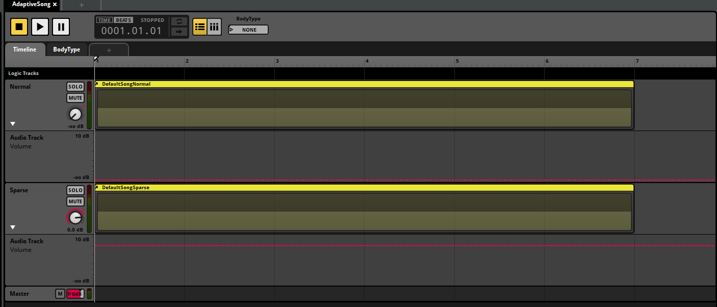

My current attempt is pictured below – I reference the Programmer Instruments in another event, and I shift the volume depending on a variable. It works great on the example, but it doesn’t work in real life (because I have no way of telling fmod what to load for each programmer instrument without playing the programmer instruments).
This is the adaptive logic ^
This is what the main event looks like^

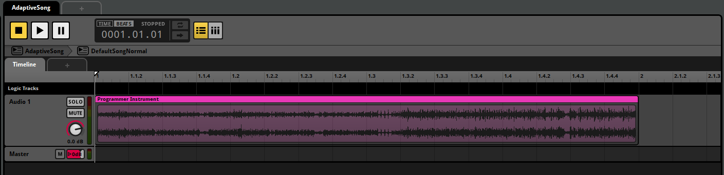

This is what one of the nested events in the main event looks like^

This is definitely possible! I have slightly modified our scripting example: Unity Integration | Examples Programmer Sounds. When we assign the event callback (FMOD Engine | Studio Api Eventinstance - Fmod::Studio::Event::Callback::Type) CREATE_PROGRAMMER_SOUND this will trigger both times the programmer instruments are played. I made an event similar to yours:
Where the fader of each audio track is controlled via a parameter.
I then use the following script to play and assigned the audio files for both the programmer instruments:

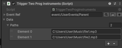

This worked perfectly! Here is the final script I ended up with – there is one change to toggle the sound manually and one change to read from StreamingAssets:

This should make it much easier for the musician and I to tell what the music would be like in game. Thank you so much!
