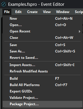

Would it be possible to package your project with the following settings:
And upload it to your profile to assist in investigating the issue?

I will not be able to share my FMOD project with the team, yet, because it’s a large project containing many different types of events of a specific game level. I’ll try to find time to strip things away so that I am sending a much small project.Thanks
