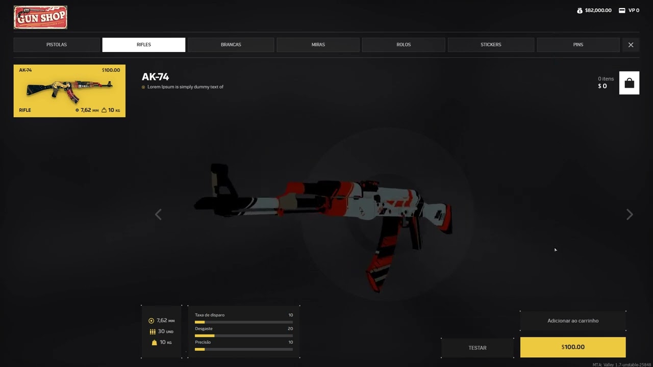

Hello, everyone!
I need to create a whoosh logic so that when the player holds the weapon and moves it from side to side, the sound follows.
I’m going to change the current visualization setup to make it a bit more similar to Valorant:
when the player clicks and holds the weapon, the 3D model will slightly zoom in and a looping air ambience sound will play. The applied effect will only happen when the player moves the mouse, and it will vary according to the speed. If the player moves the mouse slowly, the effect is more subtle, and if the player moves it quickly, the effect becomes more intense.
I need to take into account that I’m using FMOD version 1.08.12 due to limitations in my project.
Thanks in advance for the help!!
