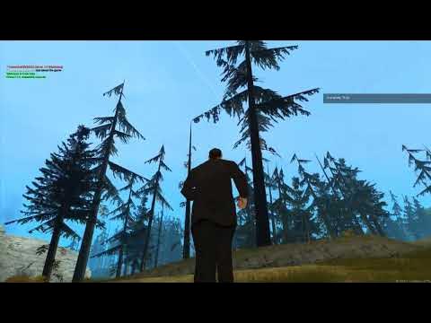

Hi everyone! Sorry for the delay. But I managed to do it, and it was simpler than I thought: I just had to define the properties of the Scatterer Distance and add a Spatializer. The real problem was in the code, since we were working with a play event, and not a play event 3D, which prevented the distance effect as I wanted.
Below is a video of how it turned out (I’m still working to improve it, I’ll definitely refactor this project many times).
And answering the @stroopwaffle2254, I don’t know which game engine the Multi Theft Auto uses, problably a autoral engine. But now you know the game hahaha tks a lot guys!
I also welcome opinions on the structure of the project.
