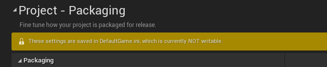

Additional info:
The Packaging settings are actually in DefaultGame.ini so you’ll have to check that out too.
And make sure you had FMOD/Destop under Additional Non-Asset Directories To Copy. I had FMOD only which passed the help>validate FMOD process
We had the same issue here too, and I’d like to add that you need to enable “advanced settings” in the project settings dialog for the options outlined by Sidera to show up.
My bank-folder for desktop is also slightly different.
Additionally, I didn’t have to check out the DefaultEngine.ini file, but that rather the DefaultGame.ini file, as chocobo pointed out above.
