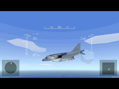

The good news is that it loads up and sounds mostly kind of work now. However I still get unplayable stuttering when certain sounds are triggered, and sometimes sounds don’t play at all.
It works perfectly in the Editor, with no errors or warnings thrown. However in the build e.g. when this bullet flyby sound effect is meant to played the game’s framerate crawls to a standstill. This is only the easiest and most reproducible Build only bug, but I assume it’s indicative of what’s happening elsewhere.
Attached is the log, which is full of FMOD related warnings and errors.
Player.log (268.5 KB)
What is going on here, and why is this only happening in the build? It works fine in the Editor (albeit audio levels are strange compared to what they should be, but that at least seems fixable and is probably an artifact of moving from 2.00 to 2.03). It’s only in the Build where it becomes unplayable with missing seemingly missing SFX and harsh stutters.

Thank you for the information and the video.
I understand, if you decide to return to 2.03 there are some more options we have for investigating the issue.
