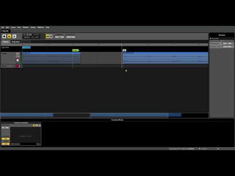

Here’s a video, for the ones wondering what we’re talking about:
