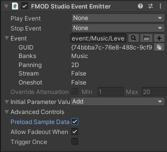

Since you are using the FMOD Studio Event Emitter it is even easier! Enable Preload Sample Data in the Advanced Controls drop-down like so:
And enable Load Bank Sample Data in the Initialization of the FMOD Settings like so:
This will preload the data when the level starts to avoid any delays when playing the event and resolve the error.
