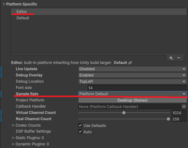

  • Has the default sample rate been changed in the FMOD Settings:
  • Are there any issues when playing other FMOD sounds?
  • Could we confirm the _sampleRate the plugin is getting by adding a log after RuntimeManager.CoreSystem.getSoftwareFormat(out _sampleRate, out _, out _);

Turns out the sample rate had been changed. Changing this has fixed it right up.

Hey guys. I’m getting the same error but setting the sampling rate to platform default did not fix it for me :frowning:

Thank you for the information. Could I please grab your FMOD and Unity versions? Would it be possible to test a couple samples rates and let me know if you see any improvements?
Was the sample rate set for the Editor or the Default platform:
Could we try adding the platform settings to make sure we are getting the sample rate we expect:

I tried all the sample rates in the sample rate dropdown for the Editor platform. I can reproduce the issue with all of them. I did notice that with 48 kHz, I was not able to reproduce the issue during one test and had to test again. I am testing locally on the same machine with 2 game clients (same microphone). So the issue is not 100% reproducible but fairly easy to reproduce.
