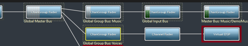

Thank you, I was able to get it running. I spent some time running in and out of range, seeing the DSP becoming virtual:
However, I was not able to reproduce the issue.
