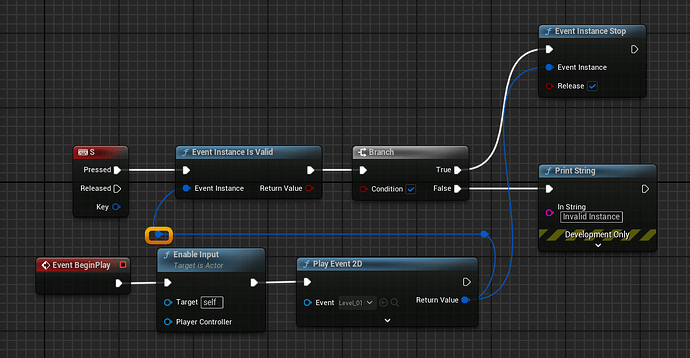

You would want to call stop on the event instance returned by Play Event 2D in this situation, i.e

That is correct.
An FMOD Audio Component is a separate, higher level entity to an Event Instance. When you drag in an FMOD Ambient Sound into your scene from the Content Browser for example, you can see in the Details pane that it has an FMOD Audio Component attached:
If you had a reference to that in your blueprint you would call Stop on that. Alternatively you can add an FMOD Audio Component using the Add Audio Component node and manipulate the returned FMOD Audio Component.

Could you add the Event Instance Is Valid node:
To make sure there aren’t issues when trying to interact with the instance.

Could you add the Event Instance Is Valid node before the stop node:
To make sure that there isn’t an issue with the instance that is being referenced.
