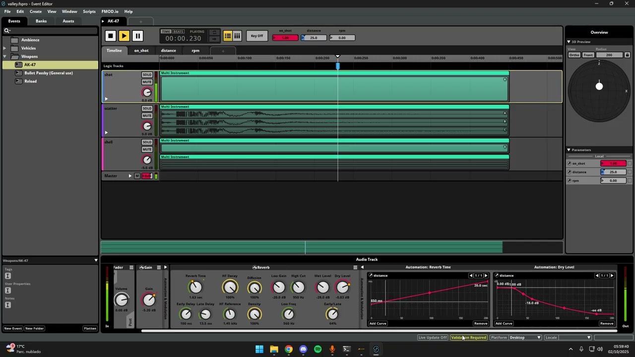

Hello! I’m new to FMOD and also a beginner. I’m creating a sound design for weapons for my project (don’t worry about development terms, I’m not a developer, someone else is taking care of that part).
My project consists of 2 different types of shots: semi-automatic and automatic. I’ve already set up these logics and they’re working fine (I used a WarThunder project as a reference).
Now, I need to create another sound, but with an echo effect, for people who are hearing the shot from a distance, away from the shooter.
The audio assets I’m using are unique shooting sounds, not loops.
Basically, I need to create a logic where one sound can overlap another, even if it hasn’t finished playing yet.
My on_shot logic depends on the audio duration and a parameter RPM that I created to define the firing rate. It works perfectly for the event without echo.
Alternatively, instead of using other audio assets with echo, can I apply an echo effect to my current event based on the distance?
Thanks in advance!

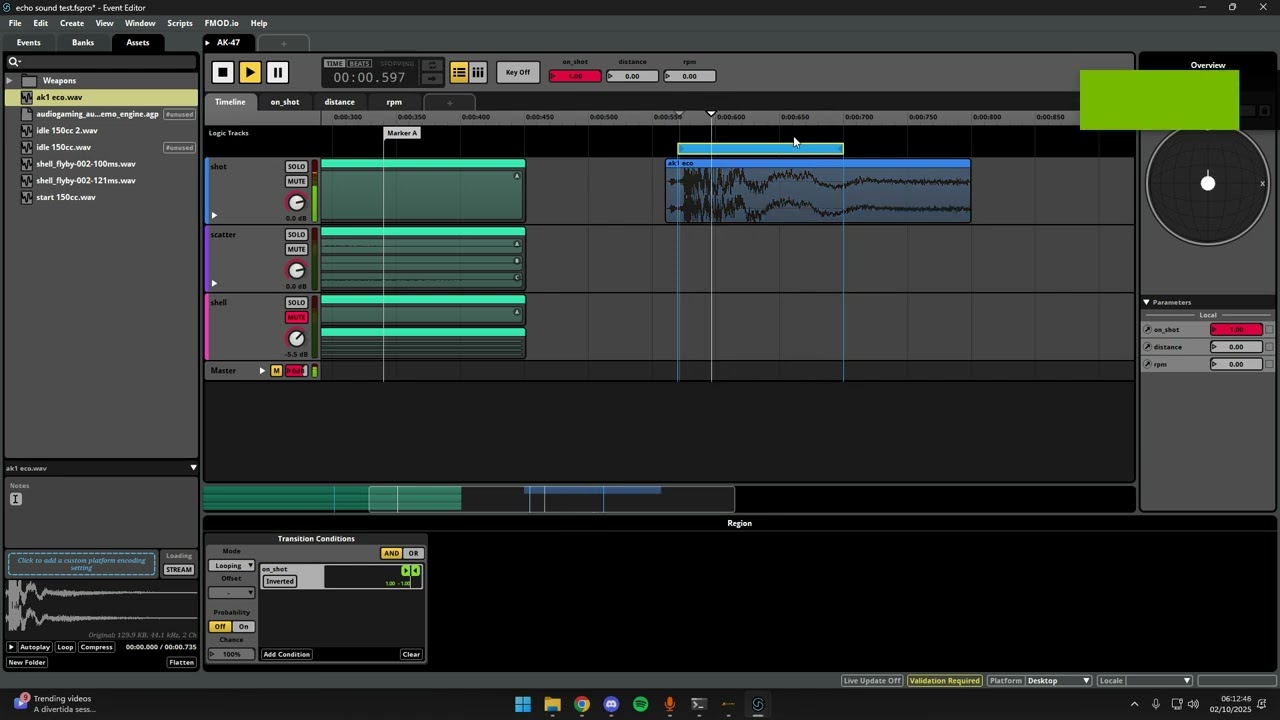

What I need is to apply an echo effect to the last shot I fire (mainly in automatic mode). I tried using a sound asset of a shot with an echo, but I couldn’t use it properly in automatic mode since the sound is a bit longer, and the loop applied to it doesn’t give me the fast cadence I need for the shots. The shot keeps repeating, but at a slow pace. In my current project progress, the ideal situation would be to use a sound with an echo and make it repeat, cutting off the echo in automatic mode, so that only the last shot plays until the end (creating the echo effect).
I’ll leave a video below showing the current state of my project. I’ll be extremely happy if you suggest a simpler logic, but the one that made the most sense to me right now is the one I mentioned.
The second video shows the expected behavior: when in semi-automatic mode, the shot plays until the end. In automatic mode, the shot loops within a specific region of the audio, and when the player releases their finger from the trigger (last shot), the sound repeats until the end.

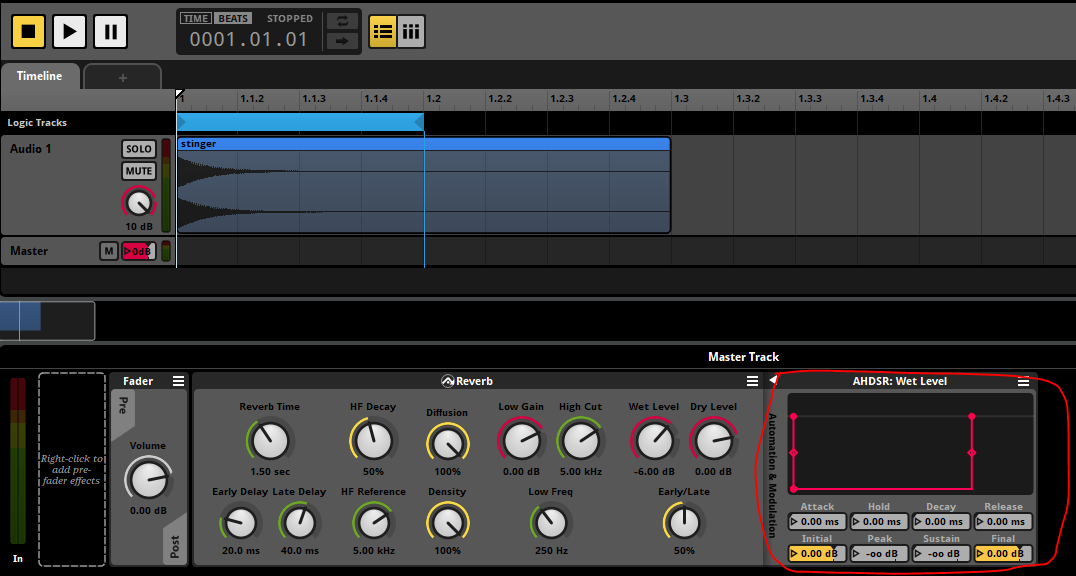

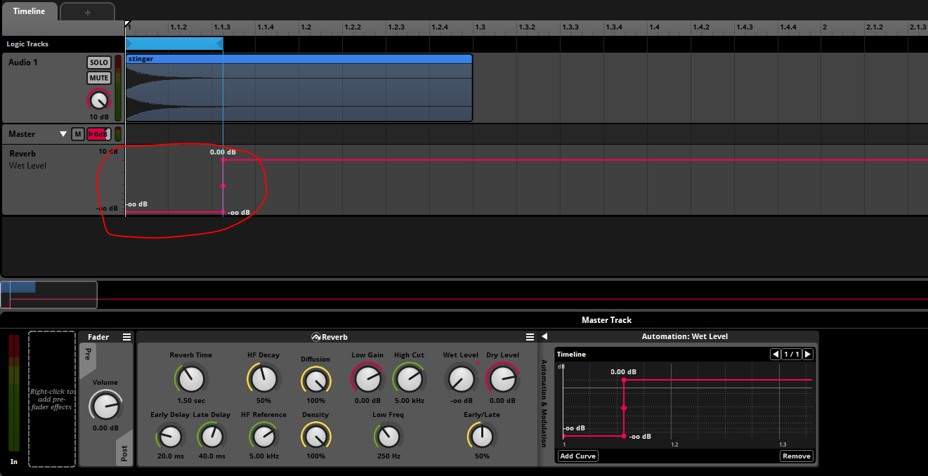

In order to have only the final shot have an echo/reverb effect, I suspect what you want is to either:
  • Use the timeline automate the wet level of the echo/reverb, so that when the timeline exits the looping region, the wet level is increased. You will also need to add the Event Condition “Not Stopping” to the loop region to do this.
  • Modulate the wet level with an AHDSR (this will only work if the shooting is being stopped by stopping the event). This will cause the wet level to be inaudible when the event is playing, and then increased when the event is stopping.
Give those a try and let me know whether one of them addresses your specific case.
