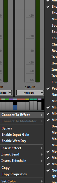

Hi there, noting here that it would be a great feature to don’t have the window pop-off (see attached pic) every time you select/unselect an input/send on compressor/sidechain-send.

yes, sorry, was not really sure how to describe it. Ideally the menu shouldn’t close once selecting one of its commands. Not only for the “Connect to Effects” but also for example on the compression “sidechain input selection”. Any menu that has the option for multiple selections to don’t close every time you select one option, or add a “shift + click” to keep the menu open.
