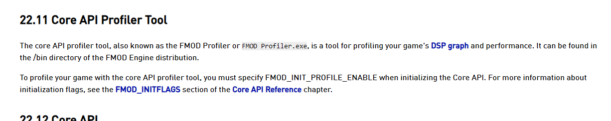

I thought that the profiler in that folder was the Studio API Profiler tool and that the Core API Profiler tool was a different one since the screenshots in the user manual for each one are completely different.
And the fact that I as a new user only can include one picture and had to do some MSPaint magic to get all the images in one post was mildly annoying, but I understand why since some people would spam the forum with stupid things. Im using the windows platform.
Thank you for sharing the screenshot!
Sorry for the confusion.
The Studio API profiler shown in the manual is the profiler built into FMOD Studio (accessible via Windows>Profiler). The profiler executable located inC:\Program Files (x86)\FMOD SoundSystem\FMOD Studio API Windows\bin is the Core API profiler, which is why the UI looks different.
