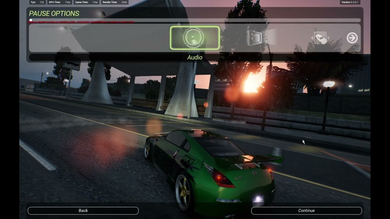

We now made the project ready for Linux as well, and wen starting the game we receive these errors.
LogFMOD: Error: ../../../studio_api/src/fmod_runtime_manager.cpp(1300) - DSP plugin returned an error, bank will not load properly.
LogFMOD: Error: Failed to load bank Skids: A requested output, dsp unit type or codec was not available.
LogFMOD: Error: Failed to load bank CAR_04: A requested output, dsp unit type or codec was not available.
The plugins are totally fine in FMOD but Unreal seems to not find them!?
I already read the documentation but i must say its a bit confusing and unclear.
Best regards.
