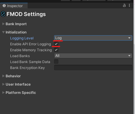

If the issue persists, could you please tick API Error logging and set the Logging Level to “Log” (Unity Integration | 8. Settings | 8.2 Initialization | 8.2.1 Logging Level) to see if you can get more error logs from the console?
