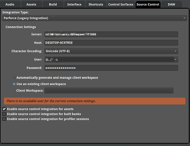

The legacy integration doesn’t let me connect, I get There is no available user for the current connection settings.

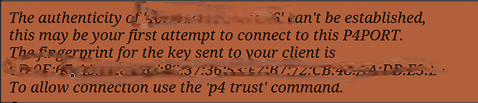

Before this message, I got the authenticity of… can’t be established message.
Running p4 trust yielded ‘trust already established’.

Try setting Character Encoding to None when using Perforce (Legacy Integration).
Hi Andrew, tried that, unfortunately it doesn’t help.
It still doesn’t seem to connect properly, since workspace and user listings are empty.

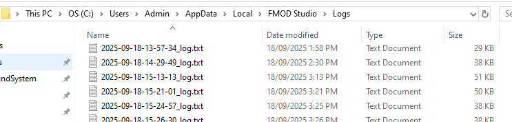

Hm ok. I’d still love to see your logs when this issue is happening. Can you look in :
%HOMEPATH%\AppData\LocalLow\FMOD Studio\Logs
%HOMEPATH%\AppData\Roaming\FMOD Studio\Logs
They’ll be in there somewhere. The files look like this :

It must have been something with the fingerprint I passed to p4 trust. I did it again and it worked.
