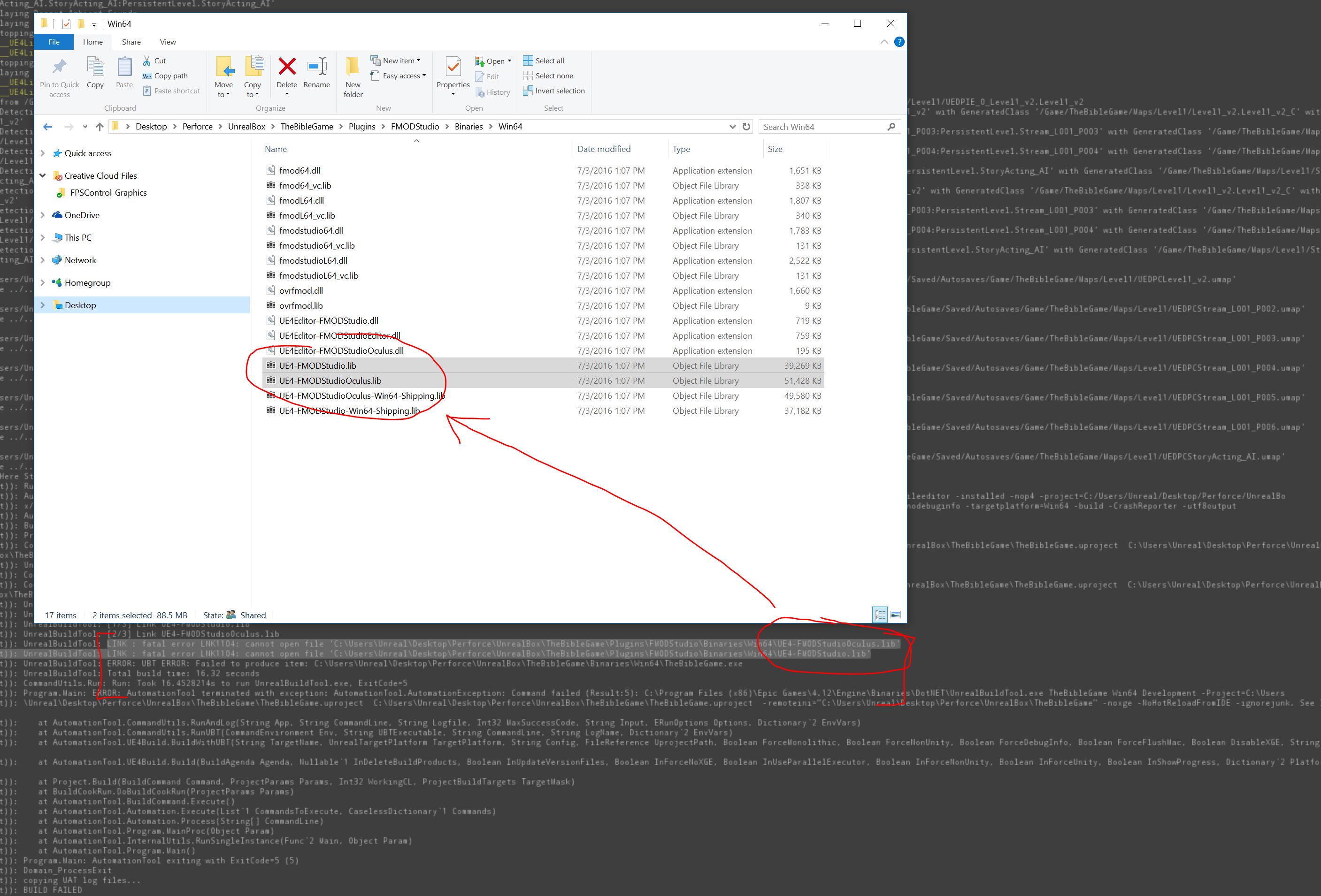

Once I finally got FMOD to cook our game, I had to upgrade to 4.12.5 and the party starts all over again.
This time, it can’t find files that are clearly there.
Here’s a screenshot:

Update: It’s able to package and cook when the FMODStudio folder in Plugins is checked out in Source Control.
Without it, FMOD doesn’t seem to have access to the .lib file.
So, if those files (I did the whole folder just to make sure) aren’t checked out, it won’t run.
I’m curious to know why only FMOD fails to build when not checked out, but at least for now it works.

UE4 will rebuild the plugin automatically if it thinks it needs to, which includes if the engine version is different and possibly if the minor patch version is different. If UE4 decides the rebuild the plugin then those files will need to be writable, otherwise you will get that error.
There are a few ways to do it, one is to check it out, let it build, and check it in. Another is to mark the files as writable even when not checked out in P4.
