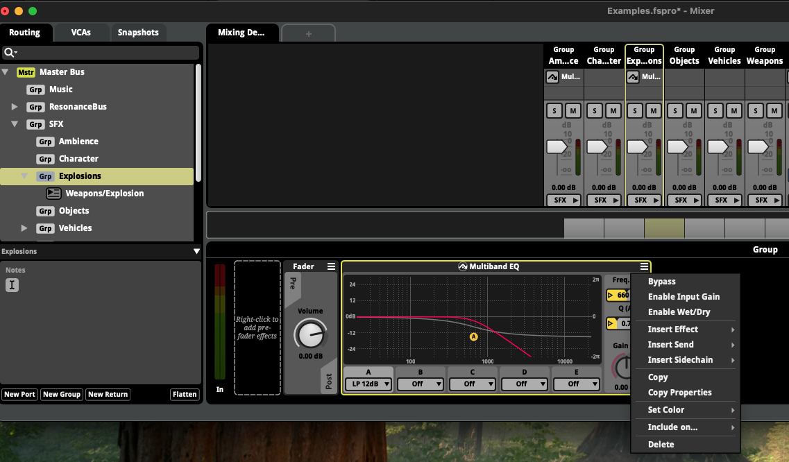

Has anyone experienced the convert to effects button missing when right clicking on an effect like Multi-band EQ or Reverb as well as the effects tab missing from the application entirely. Im working in 2.03.08 on m1 Macbook pro. OS is 15.3.2.

Could I please ask for a few more details about the reproduction steps? Specifically, are you referring to the Convert to Shared Effect option missing from the Mixer window or from the Event Editor?
Just to clarify, the Convert to Shared Effect option is currently not supported for effects placed directly on group buses, which might explain its absence in some cases.

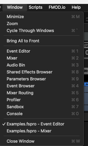

Regarding the missing Effects tab, are you referring to the Shared Effects Browser not appearing under the Window menu?
