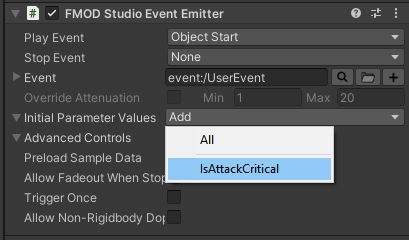

Could you please try adding the event to an FMOD Studio Event Emitter: Unity Integration | Game Components - Studio Event Emitter and assigning the Initial Parameter Value for IsAttackCritical
and let me know if you can hear the pitch change using the method. This is just to confirm that the parameter changes are working.

Hey, thanks for replying!
I can confirm that parameter change is working, I actually achieved pitch change using a different approach.
Instead of adding automation to “Pitch” inside “Pitch shifter” effect, I found “Pitch” field in a different place (by just clicking on an individual instrument I found “Pitch” field under “Volume”):
When I automated it here, it worked, meaning parameter and my code worked correctly.
Maybe has something to do with “Pitch shifter” effect specifically?
