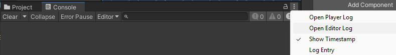

Are you able to share your entire editor log file? You can locate this from the editor console window
