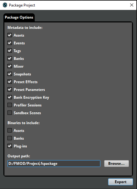

You could upload it to a file hosting site and then DM me the link might be the easiest. Could you also package your FMOD studio project along with the Unity project?
File -> Package Project
Thanks
