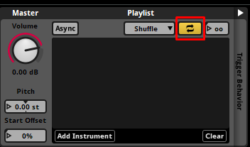

Edit. I want to achieve what is shown in the attached picture: a multi instrument that uses samples with different length and different loop points (represented with the red lines)
This is simply done by clicking the “loop” button in the multi instrument properties:
Correct me if I am wrong, but that method does not allow me to set a loop point (i’d like to be able to use the reverb tail of each sample).
With your proposed solution, I should cut each sample to be exactly “X” bars long, but cannot benefit from using those samples’ reverb tail…or is it a way to set a loop point for each sample inside a multiinstrument?

I have attached a picture to the main post to bettter illustrate what I want to achieve
True, you won’t be able to play a reverb tail. I also miss a feature to specify the end point of an multi instrument entry, while still playing its tail.
There’s indeed no way to achieve what you’re looking for using multi instruments, from what I know. I guess you’ll have to find another design.
