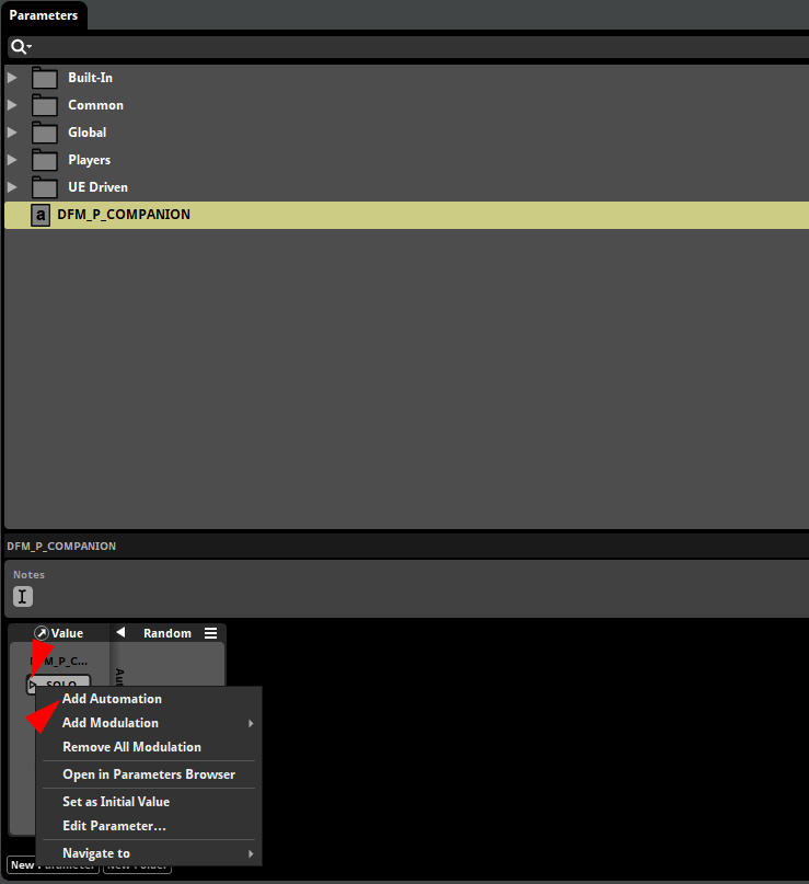

Wow so I typed out an essay with screenshots and everything explaining why I still don’t get it, and then right before submitting I discovered that you can right click on the word “value” in the command instrument and add automation to just that.
God damn I can’t tell if I’m a complete idiot, or if it’s FMOD’s fault for hiding menus. Probably both.
Either way, I finally got it and I am very grateful to you for your help and patience. This will be a huge time saver for me. Thank you.
