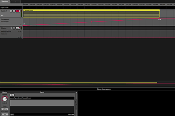

Are you supposed to be able to automate parameter values on the timeline?
See below: you can’t add a timeline automation to a parameter value from the menu…
But, if a nested event is using that parameter, you can add that parameter to the timeline of the parent:
That parameter value now changes over the timeline, and you can see it changing in the nested event, but it doesn’t have an effect (e.g. you map it to volume in the nested event, you can see the parameter increasing, but the volume doesn’t change).
However, if you then use that parameter to control something in the parent event, that does work and you now have timeline automation for a parameter value. Really useful and I love that I can do this, but I’m wondering is this supposed to be possible?
I ask that because if it is then why can’t we just add a parameter automation directly to the timeline from the menu in the first photo, instead of needing this workaround?

Just to clear up a couple of things I don’t quite understand I’ve made a quick video to hopefully show what I mean (this is 02.17 btw):
So when I said it didn’t have an effect I was relating this behaviour: the parameter changes but it doesn’t seem to have an effect on whatever it’s controlling. I’m not sure why the volume isn’t increasing here?
But now in the parent event I can automate the master volume from that parameter and it does work:
When I make a second parent + nested event with an identical setup, the volume now doesn’t change, which I presume is related to what you said about not allowing a timeline being instanced in multiple events?
Whatever is happening, this behaviour seems useful because I can use one lane of timeline automation to control a bunch of things in one event, which I don’t think is possible any other way without copying and pasting curves?
