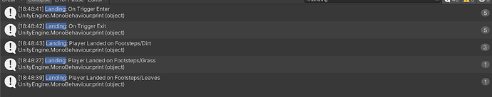

Attaching below screenshots of the Unity Console Log - self explanatory, but “Landing - On Trigger Enter” is when the player enters the trigger zone, “On Trigger Exit” is when the player leaves the trigger zone, and “Landing: Player Landed On [Ground Type]” indicates that the landing sound function was triggered to play the FMOD event which correlates with the player’s footsteps - you may notice the last function occurs a second after the exit is triggered, that’s because for testing purposes I triggered the function via a Coroutine with a 1 second delay, but this will obviously not be the case in the final product.

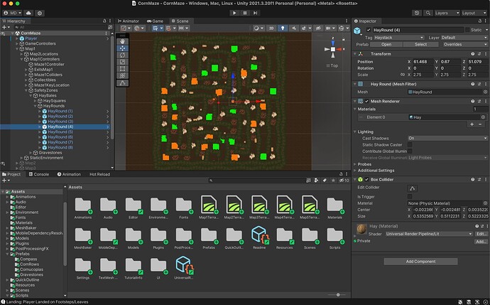

Also attached below are screenshots of each of the FMOD events: one for landing on dirt, one for grass, one for leaves, and one for mud. Also including screenshots of the hay bales in Unity, with their inspector details - bales 3 and 4 are the two that work properly, the rest do not work. I turned the volume nobs all the way up for testing, to ensure that I wasn’t confusing the landing sound with a regular footstep.
