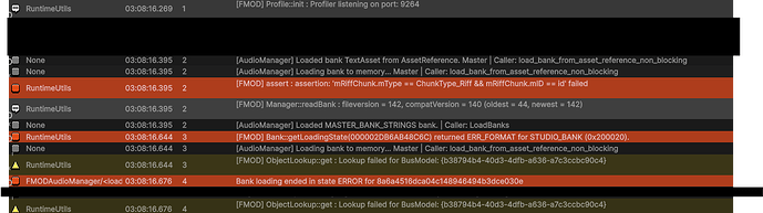

Well It works using Use Existing Build but then I switch to Asset database and more errors.
This is using AssetDatabase.
I don’t want to go back to Runtime.LoadBank if it means having to wait 5 seconds every press play.
Solution?

  7. master.bytes + Addressables AssetDatabase option + loadBankMemory() = ERROR (ss above)!
