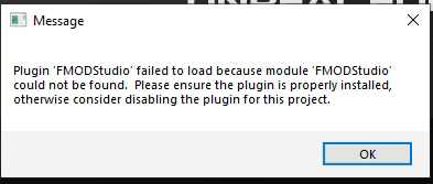

Hi Derek,
If I do that (adding FMOD after the generation of the installed build), whatever version I’m using (with or without DDC) I have el famoso :
fmod
