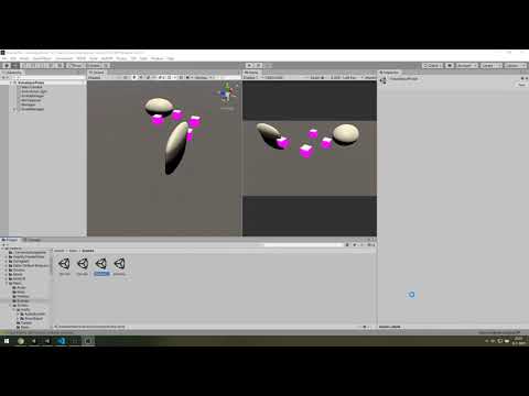

I’ve done similar stuff like this with the Unity sound system:
Scaling based of an audio file/mic input

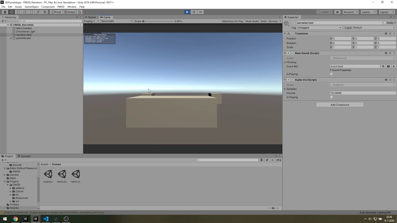

In the Tutorial Unity Files, I found the visualizer scene, which helped me a ton with understanding how things work and I was able to convert my Unity audio method (1st scene in the video), to do the exact same thing but with FMOD:
