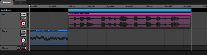

If you wanted to elaborate on this behavior, for example by playing some kind of radio SFX when swapping channels, a basic implementation would be something like the following:
You can “change channel” by stopping and then restarting the above event - it will stop playing the current programmer sound when stopping, then on starting play a short burst of noise as a “change channel” sound effect, followed by playing the looping programmer sound again, in the callback for which you can create a new stream and specify the channel to use.
