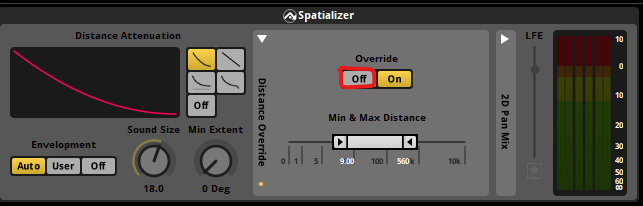

It may be an issue with trying to override the min and max distances on the spatializer and in Unity.
Could you try disabling the Distance Override on the spatializer for me?

I found the Unity asset Viking Village, I placed an emitter using your event in a similar location and was able to reproduce the issue. Can you confirm you have disabled the Distance Override and rebuilt your banks
And saw the rebuild prompt in Unity:
After doing this I was able to hear the specialization of the waves.
