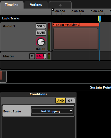

Concerning your problem, I think I found a workaround:
Don’t put the snapshot in the action sheet but in the timeline. Instead, put an event stop command in the action sheet, after the programmer instrument.
Instead, the timeline will handle the snapshot, with a sustain point conditioned by the event state.
However, there is a potential problem: it will stop all instances of this event. This is why I requested a ‘self’ option for stopping events in a recent post of my own.
