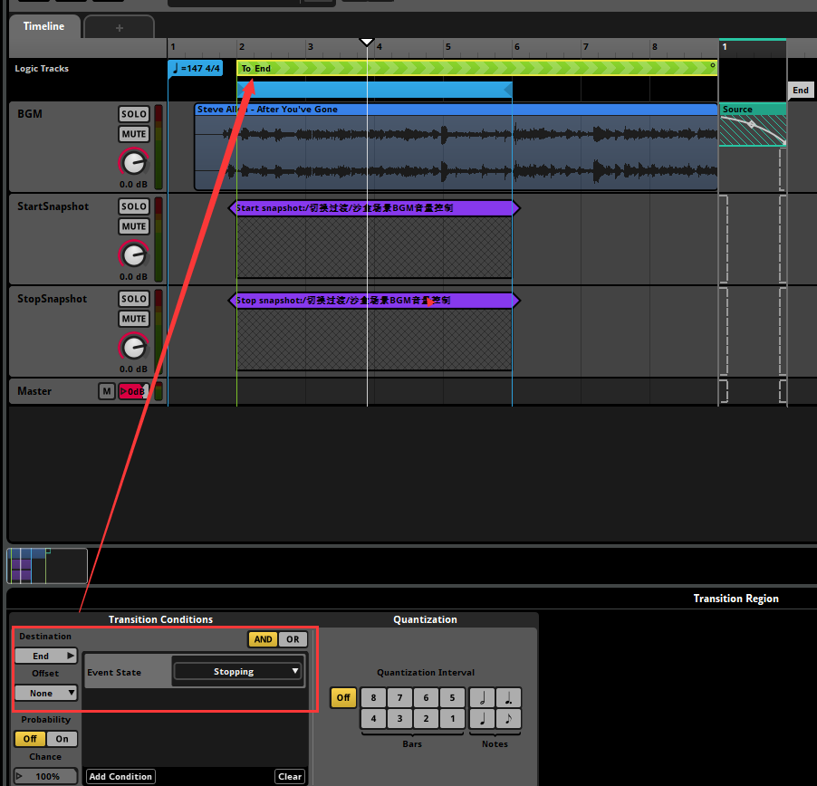

Question about event state "Stopping" and transition cross instances
We used command instrument to implement such design. When Player enter battle ready state, we lower the volume of the BGM by using snapshots(which name in chinese), while play the Battle BGM. But player might quit such state at any time. In that case we want to stop the battle BGM, then turn on the previous BGM.
if we use snapshot instrument instead, the snapshot will stop immediately when the Battle BGM stopped. Since we want a fade in fade out transition, we switch to command instrument implementation.
pic2. we start the volume adjusting snapshot when start the Battle BGM
pic3. we set the condition as event state stopping
In the “Stop Snapshot” command instrument, I did such setup. But when I hit the stop button, the Battle BGM instance stuck in the Stopping state. I looked up related topic in the forum. It is said that, if we uses stopping condition, Fmod will not really stop the event instance and left it to developers.
I wonder, in such case, how should we implement the “Stop”? Of course we can try to use parameter condition. Moreover on the other hand, whats the best practice to implement transition (e.g. crossfade) between different instances?

Well, I think I’ve found a workaround about this.
I found that, if the playback marker leaves the snapshot instrument area, the snapshot stops itself with AHDSR activated. So instead of making snapshot instrument cover all the timeline, we shorten its length since we only need it when the event is looping in the loop region above.
Then, our player may quit the battle intro at anytime, so when they quit, we use a parameter to activate the transition region(mark in the picture). We may jump to a kind of escaping sound effect with a fade out. And at the same time, the snapshot, which controll the volume of another group, stops with a decay, allowing the volume raise slowly.
This seem to work just fine. But I’m still looking forward to your replay, about the “stopping” question.
BTW, I try to call the EventInstance.stop() and pass the allow_fade_out, but the event seems to stop immediately. And it doesn’t trigger the stopsnapshot instrument (in my first post).

感谢回复. 先在这个post里回一下. 我后面看了很多文档的说明, 看来之前没有仔细研究过.
测试了一下,snapshot的stop与untrigger.
  1. 当playback position在instrument上stop,即使进入了stopping的状态, 也不会应用adhsr.
  2. playback position离开instrument区域,也即untrigger,即使是跳转, 也会应用ADHSR
  3. 最上方的pic3所显示的通过command instrument来stop snapshot, 会触发ADHSR
目前看来, 如果想要触发snapshot自身设置的intensity ADHSR, 直接触发untrigger似乎是最简单直接的方式. 所以我们之后大概率会采用我第二个回复的实现方式.
实际上我后来发现, 由于我上面的event是包含在一个parameter sheet当中, 而我直接对这个parameter sheet进行stop操作会直接停止这个event. 而如果对event直接操作,则会触发AHDSR.
关于这个问题, 如果想要触发snapshot自身的AHDSR, 总结一下:
  1. 当使用snapshot instrument时, 可以让playback position离开instrument区域
  2. 当使用command instrument的start snapshot event的时候, 再加入一个stopping condition触发的stop snapshot event也可以触发. (前提是让event顺利进入stopping)
A brief summary about how to apply AHDSR of a snapshot:
  1. When using snapshot instrument, the AHDSR will be applied when playback position leave the snapshot area.
  2. When using Command Instrument to start a snapshot event, the AHDSR will be applied as long as you add another Command Instrument which “stop snapshot event” by “stopping conditon”. (Make sure you enter stopping state successfully).
After looking up the forum and the documentation. When using “Stopping Codition” in the event, calling “Stop” will let the event enter “Stopping State”. In that state, AHDSR will be applied and the event won’t stop till it reach the “natural end”. The “natural end,” in my understanding, refers to when the playback position reaches the end of all tracks.
But what if the “Stop” is called in a loop region? Well I tried it and the event stucks in that loop region and never ends. To break this loop, I add a codition to the loop region, showed in the picture below.
It breaks the loop region when enter “Stopping State”.
Or, if I want the event stop right away, I can also add a large traition region.
I wonder whether the work around above is the recommanded approach. Looking forward to reply.
