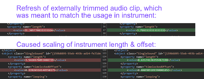

Start offset was scaled too. Maybe the change in the xml files illustrates the behaviour:

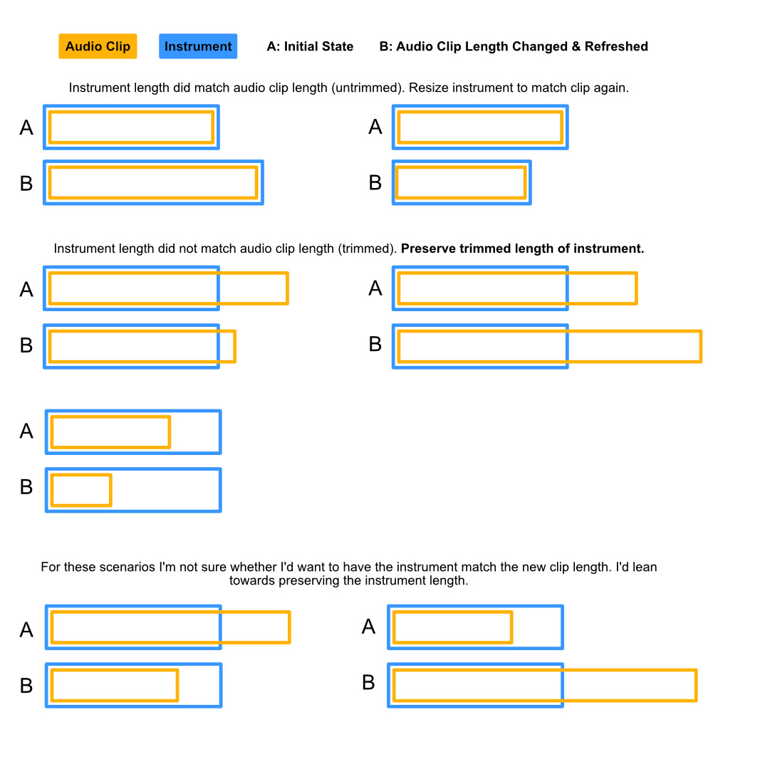

For what it’s worth, I’d prefer to have the instruments only resize if they previously matched the length of the audio clip. Or have an option to not have the instruments change at all when refreshing assets.
Tried to come up with what scenarios there could be…
