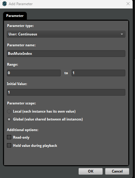

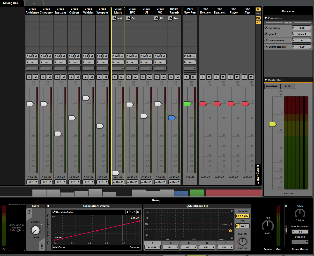

  • Go to Windows > Mixer, In the Mixing Desk, select target bus and right click to add automation to its fader’s volume.
  • Create a global parameter(.e.g BusMuteIndex in this case) with initial value set to 1, add the curve to the automation of the fader’s volume and adjust the curve.
  • Go to Windows>Preset Browser, select BusMuteIndex and adjust the Seek Speed
  • In your C# script, you could then call RuntimeManager.StudioSystem.setParameterByName("BusMuteIndex", 0); to smoothly mute the bus and call RuntimeManager.StudioSystem.setParameterByName("BusMuteIndex", 1); to smoothly unmute the bus in this case.
