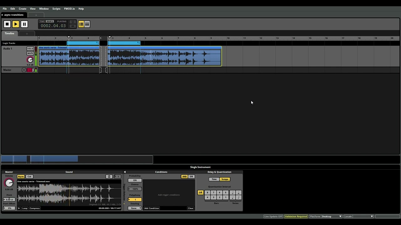

I’m having some trouble getting this to work. When I try making an event like the one shown in the screenshot and setting the instrument’s polyphony to 2 or 1, the old instance of the instrument is untriggered when the playback position passes through the transition timeline, resulting in the instrument ceasing to play when it subsequently finishes playing out its content.

@joseph, also you have to create fades in the transition timeline both from the destination and from the source. I hadn’t done that in the first screenshot, but I did show it in the solution screenshot

To the best of my knowledge, this workaround shouldn’t work. I do not understand how you are able to get it working. Are you able to send us a project that exhibits the workaround?
It simply continues to play the content of the async instrument, as it usually does when an non-looping async instrument is untriggered:
Doesn’t it behave like this on your system?
That is exactly how it behaves on my system: The instance of the instrument is untriggered when the playback position passes through the transition timeline, resulting in the instrument ceasing to play when it subsequently finishes playing out its content.
This makes this method incapable of (for example) continuing playing an infinitely looping sound through a transition timeline, because the fact that the instrument is untriggered guarantees that it will stop eventually.
