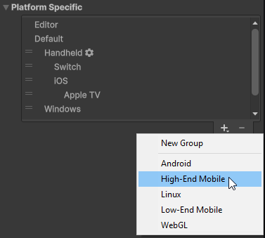

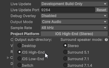

Hi Joseph,
I haven’t had any trouble with building a separate set of banks with its own encoding settings, but on the Unity end the platforms that I can specify are limited to this pre-defined list
There is only one iOS platform and I cannot make another. Within the settings for iOS I can choose between my two sets of iOS banks as you say, but I cannot make a second iOS platform to assign the other banks to.
Is this settings window the only place where the banks for build platforms is defined? Unity’s Build Profiles window shows how our various other settings are distinguished, but there doesn’t seem to be a way to specify the FMOD platform settings to use in each build profile.
I could assign my different iOS banks to the “High-End Mobile” or “Low-End Mobile” platforms, but I can find no information about which devices these will actually target, and whether I am able to manually assign them to build profiles.
Ah! You’re right. It appears that Unity does not support the creation of multiple different specifications for the same category of platform within a single Unity project, meaning that FMOD’s ability to do so will be of no use. We recommend contacting Unity about this and making a feature request, as wanting to create different builds for high-end and low-end mobile platforms is a common and reasonable use-case.
