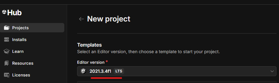

If you switch your Editor version to 2021.3.X or earlier, the Karting Microgame should appear in Unity Hub. For example:
For Unity version higher than 2021.3, you will need to manually download and install the project through the Unity package manager.
Thank you! It helped! It works.
