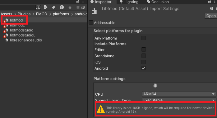

Hi there,
I just upgraded to 2.02.27 in hopes of fixing this warning in Unity. However when I build the project I still get this warning. I am using Unity 6000.0.42f1, Android ARM64, (Quest 3) and Fmod 2.02.27.

Sure thing, you can also see in the editor just selecting the plugin will show the warning.

Thank you for sharing the screenshots and error messages.
I have upgraded the Oculus plugin to the latest and tested on a similar setup, but I still couldn’t reproduce the warning on my end.
The Log you provided does seem like coming from Oculus plugin. However, the FMOD libraries such as libfmod and libfmodL should already be properly aligned.

When you had a look at your install, did you make sure CPU is set to ARM64 on the plugin?
The warning is not there if you choose ARMv7 on libfmod but appears when set to ARM64.
Edit: Just updated my project to: 2.03.07 and found the same thing.
Thanks for providing the libfmod file, it helped me confirm that it is correctly aligned to the 16kb requirement.
Yes, I have confirmed that the CPU is set to ARM64 on the plugin. I was also able to reproduce the warning messages on my end. From what I can tell, this appears to be a Unity-specific bug, as the warnings only show up in Unity 6000.0.42f1. Fortunately, they don’t seem to have any functional impact or block the build process.
Interestingly, when I previously tested with Unity 6000.0.27f1, I couldn’t reproduce the issue as the warnings did not appear and everything worked as expected. So as a temporary workaround, I would recommend downgrading to Unity 6000.0.27f1 to see if that resolves the issue on your end as well.

During the Unity build process, we encountered a warning indicating a 16KB size, as shown in the attached screenshot.
Could you please confirm whether this warning poses any potential issues or if it can be safely ignored?

Thank you for bringing this to our attention and for sharing your .lib files!
I was able to reproduce the issue shown in your screenshot using Unity 2022.3.59f1, and I’ve also confirmed that the libraries you provided are correctly aligned to support 16 KB page sizes:
During investigation, I found that the 16 KB page size warning only appears in specific Unity versions, such as 2022.3.59f1 and 2022.3.62f, but not in others like 2022.3.23f1.
So far, I haven’t encountered any functional issues related to this warning when building the project. It appears to be a false positive triggered by certain Unity versions, and in those cases, the warning can likely be safely ignored. However, if you do experience build failures or runtime problems, please let me know.
As a temporary workaround, using an earlier Unity version (e.g., 2022.3.23f1) may help avoid the warning altogether.
