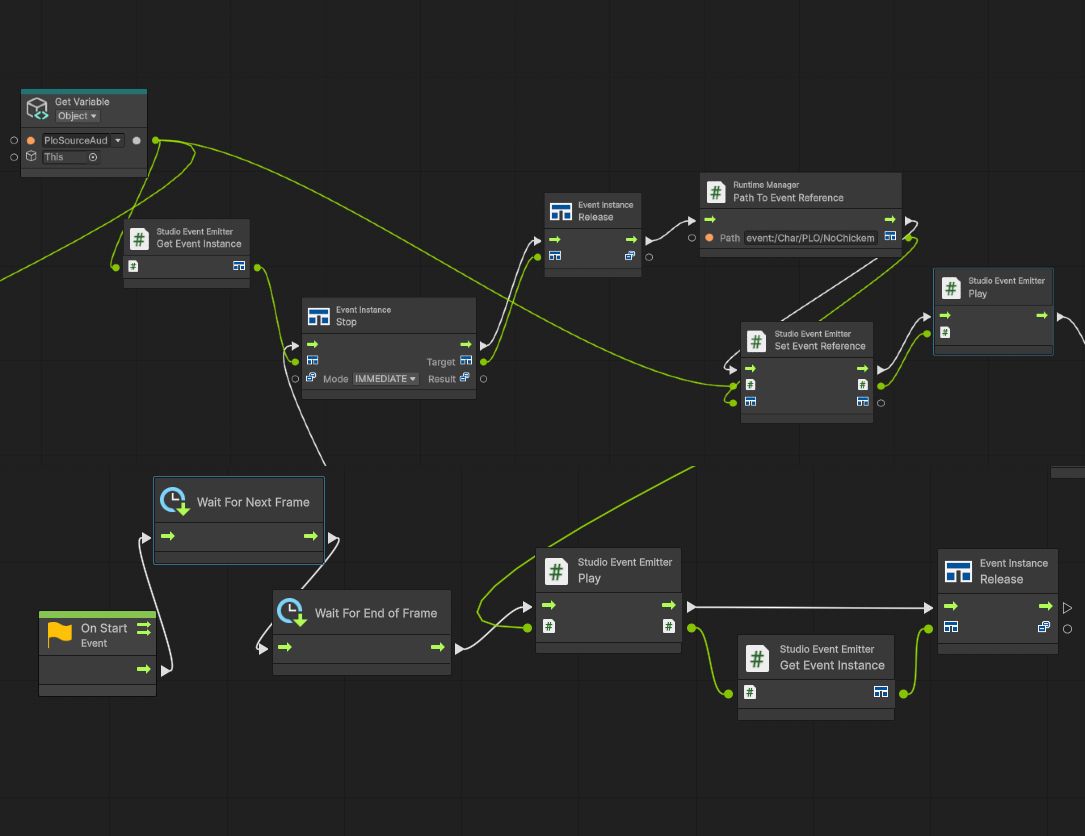

Here’s a picture of a version that tries the basic method of swapping events, and in the same image (because of the New User perk: “Nuh-uh-uh! One image at a time!”) what gets called on start, it plays the same emitter from that variable:
Aside from an unrelated oneshot, it doesn’t do anything else with FMOD, which is good because that whole Script Graph is literally too big to take a reasonable screenshot of.

Thank you for sharing the screenshots, it’s super helpful!
The built-in StudioEventEmitter is designed as a simple “one-event player.” It caches the event description the first time you play it, and it won’t refresh if you change the EventReference during runtime.

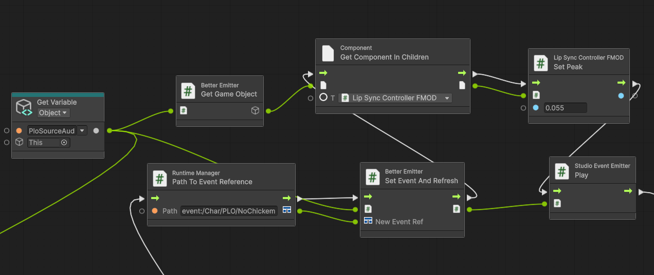

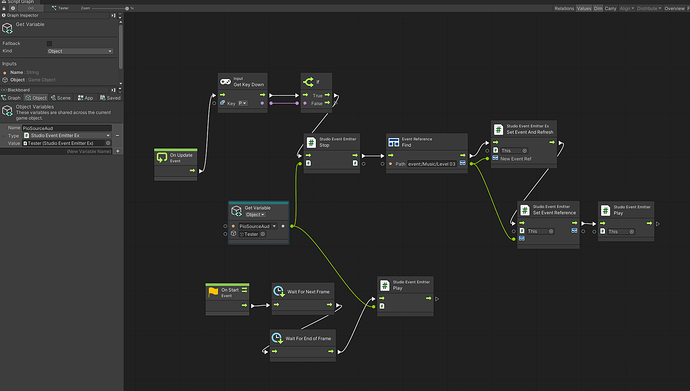

Here’s an example graph:
Hope this helps! Let me know if you have questions.
Works exactly as intended
