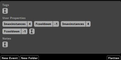

Got a weird thing going on with the user properties in events.
Every time I load Studio and click on an event that hold 2 previous user properties settings,

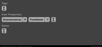

They are displayed twice. Then clicking off the event and selecting the event again, it now display the correct 2 properties…
Looks like a harmless bug to me. But just in case, does it ring a bell to anyone ?
Thanks for the bug report! I’ve added this issue to our bug tracker, so it should be fixed in an upcoming version of FMOD Studio.
In the mean time, it appears to be purely a display issue that doesn’t affect in-game behavior, so it shouldn’t cause too many problems.
