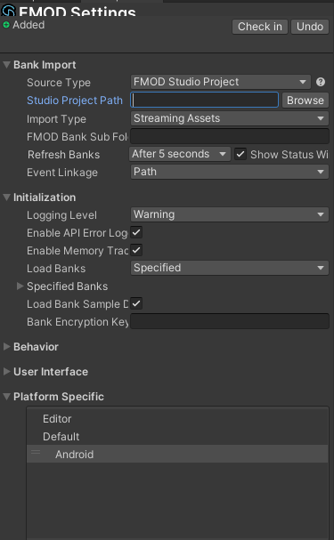

Could I please get a screenshot of your FMOD Unity integration settings:
In the Initialization settings, please set the Logging Level to Warning and enable API Error Logging. Then share the logs when trying to play the event.
