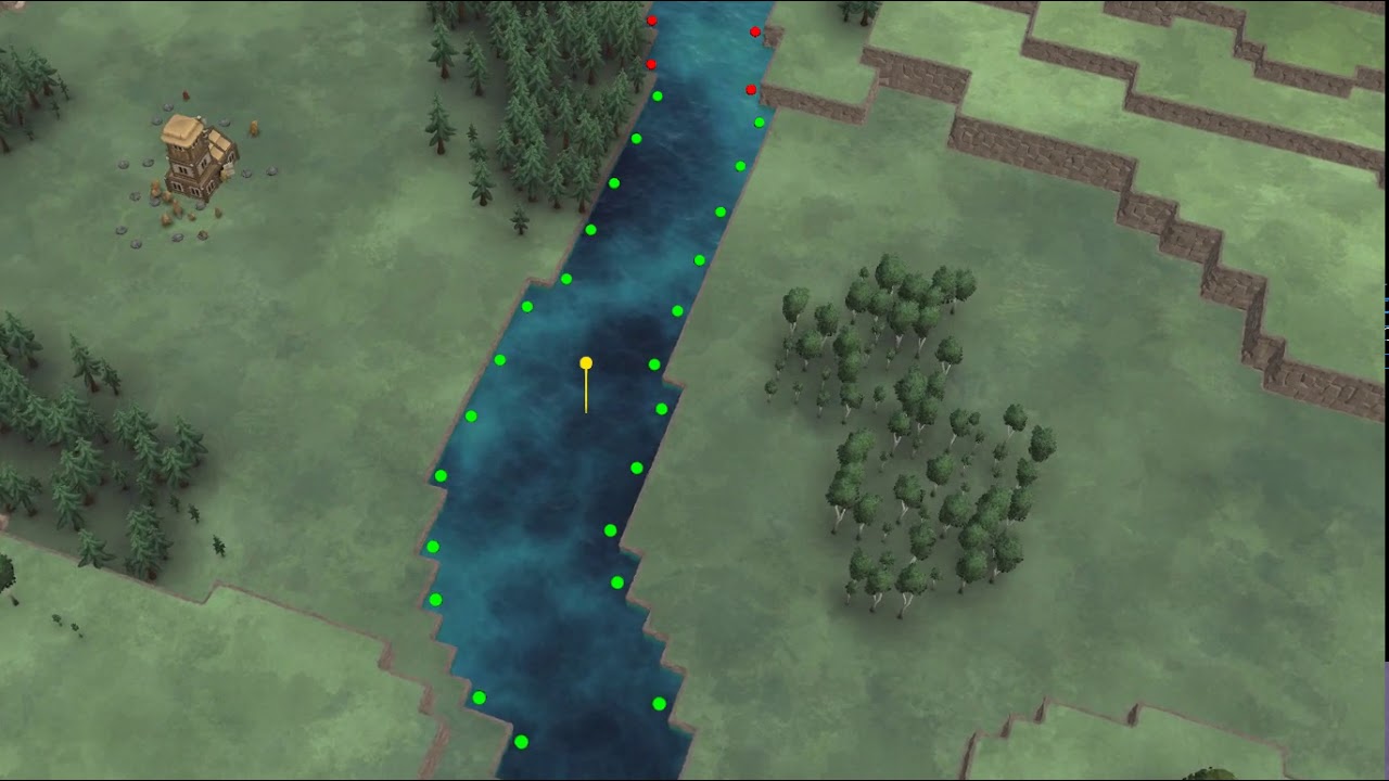

I was thinking about using Transceiver/Receiver system for this. Currently I am placing event instances (receivers) all over the river. Then, on the fly I check the distance between receiver and listener and if it is under a threshold, I start receiver event. Otherwise I stop it.

@Paalo Thanks for asking! Here is a short video. The yellow dot on a stick represents our sound listener. Red/green dots represents receiver - each has it’s own game object and own receiver event - both instantiated at Awake phase. Receivers events are started (or stopped) based on it’s distance do sound listener. If they are close enough - they are playing - green dot. If too far - stopped - red dot.

Interesting implementation, but it looks like there’s gonna be lots of phase issues and probably volume might be not even as you always hear a mix of different number of sources ? Can’t say it from video cause i got no sound in it.
@FoxyMusic Using receiver/transceivers pair causes that there is only one sound source - so no phasing and volume problems. All this green/red dots are not transmitting real sound, but they helps to calculate proper 3D parameters for a single sound event that is playing the sound.
