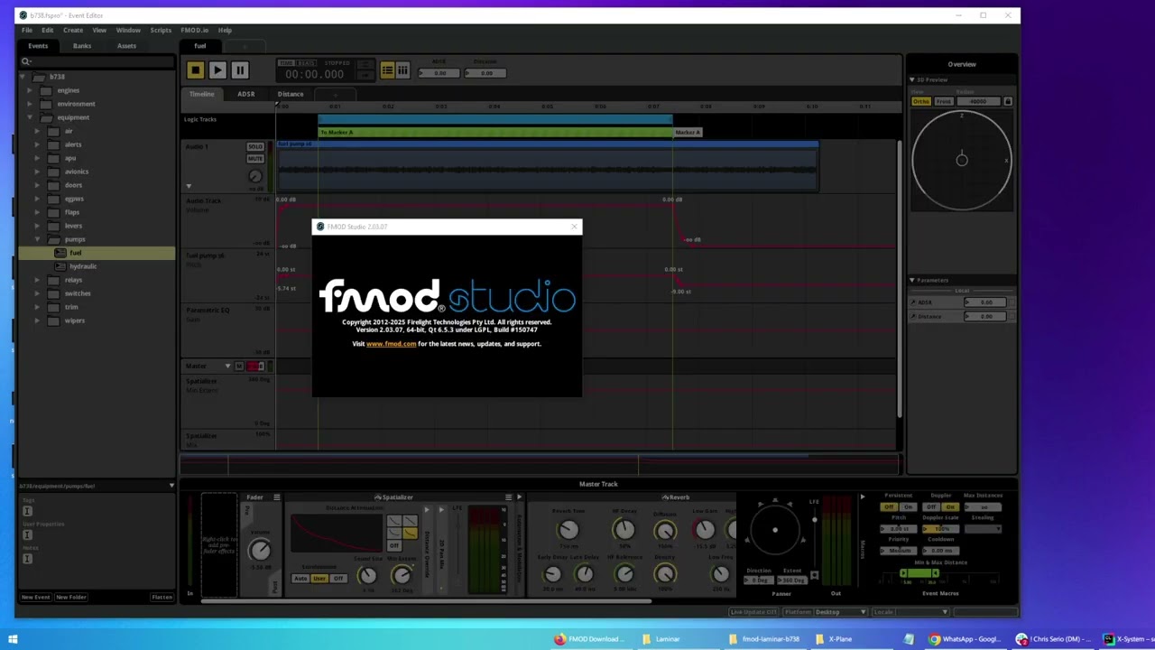

We’re in the process of upgrading our application (a flight simulator) from 2.02 to 2.03. We load sound banks from user-generated content (aircraft) both in-house and from third parties. While testing, on some of them I experienced unexpected premature stopping on some events that were supposed to play continuously, which after careful investigation I nailed down to a change in AHDSR behavior between Studio 2.03 and 2.02.
This example event is of a Boeing 737-800 fuel pump sound. You can see how the AHDSR on the parameter works differently, making the event not keep playing under 2.03 compared to 2.02. The expected behavior is that the transition region will only jump to the end marker only when the AHDSR goes below 0.98 (which happens when the event stops), but under 2.03 it always jumps to the end marker, apparently because the AHDSR on the parameter doesn’t trigger at all.

At the time of development, before we had “Event State” as a transition condition (the bank was created under FMOD 1.08 then migrated sucesive times) using a custom parameter with an AHDSR modulator was a common solution to keep playing the tail of an event after it was stopped, so we have quite a few banks that use that technique; not counting the ones created by third parties, of which we have no control.
