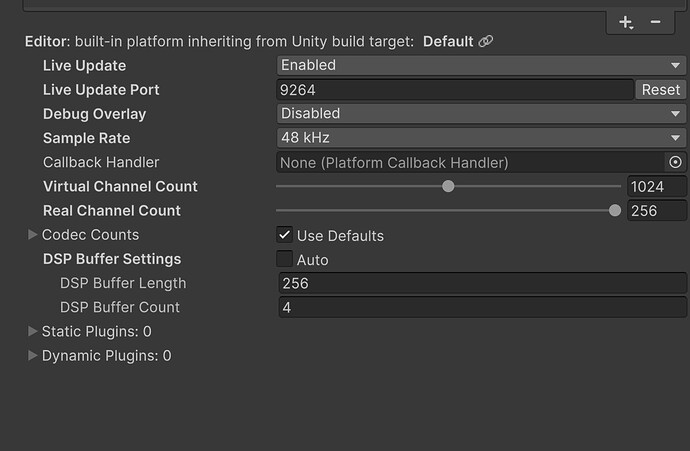

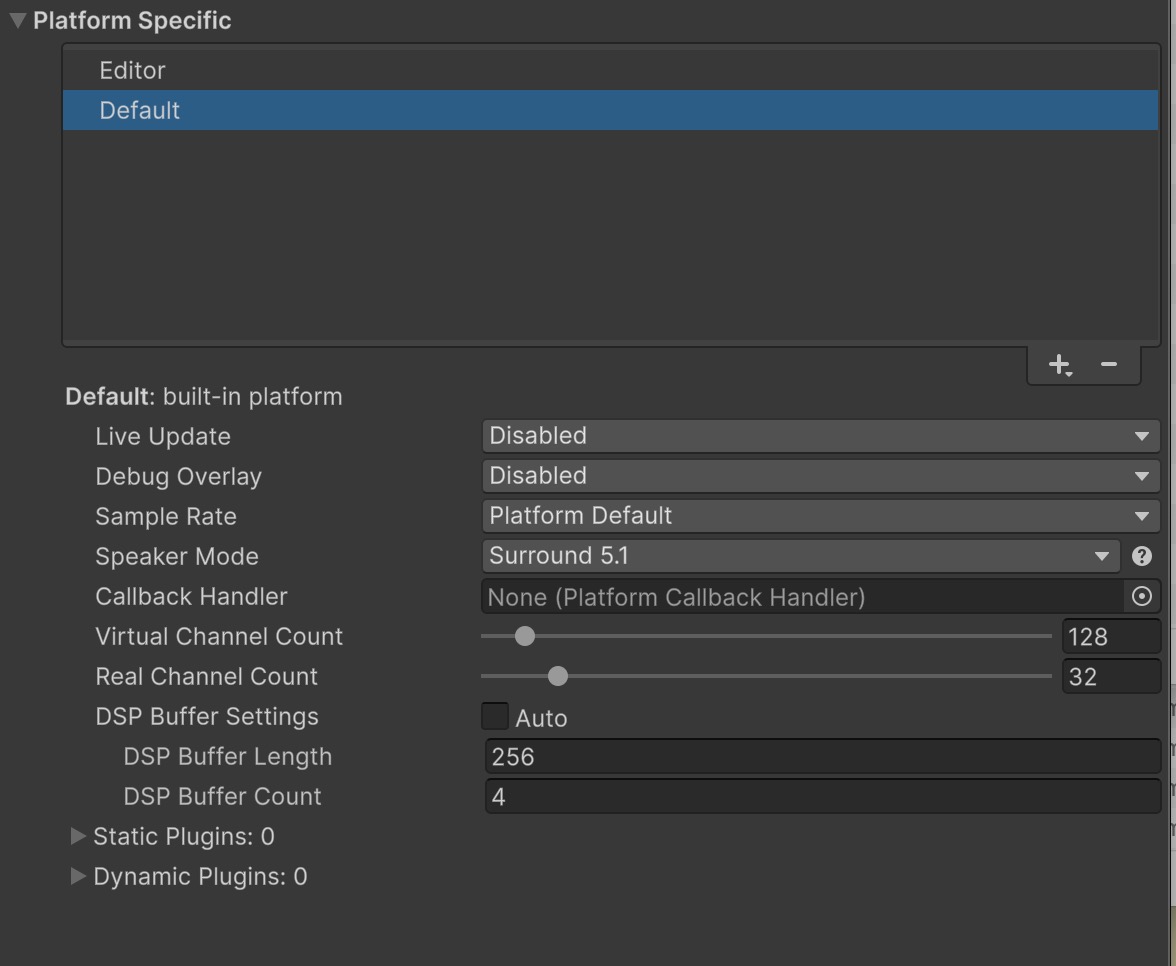

We are building for Windows PC and developing on OSX and Windows. The integration settings are attached, do they look alright?
@Connor_FMOD Any suggestions on what to change in these settings? Thanks a lot!

For the DSP Buffer Settings
could you please try:
If you do set the size manually, the bufferlength argument must be a multiple of four, typically 256, 480, 512, 1024 or 2048 depending on your latency requirements.
Reducing the size of the buffer will increase CPU usage:
Making the granularity smaller will just increase CPU usage (cache misses and DSP graph overhead).
FMOD Engine | Core Api System - System::Setdspbuffersize
