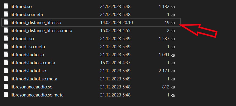

  1. I have read almost all 20k forum topics/posts and found out that the easiest way to get the plugin for Android is to download the old FMOD Android API (v1.10) with api\lowlevel\examples\vs2010\examples.sln , along with NVIDIA CodeWorks and VS 2019.
  2. In examples.sln, I chose the type as “release” and the architecture as arm64-v8a.
  3. I compiled and obtained “libfmod_distance_filter.so” with a size of 19kb.
  4. I imported it into FMOD\platforms\android\lib\arm64-v8a with import settings platform set to ARM64.
  5. In FMOD settings and Android settings, I added “fmod_distance_filter” to dynamic plugins.
  6. The result is an error on Android:
    “Error Unity SystemNotInitializedException: [FMOD] Initialization failed: Loading plugin ‘fmod_distance_filter’ from ‘libfmod_distance_filter.so’: ERR_FILE_NOTFOUND: File not found.”
Device information: Android 13, ABI: arm64-v8a.
I have been trying to obtain the Android versions of the Distance Filter for a week already, running back and forth with different combinations of the plugin name, platform, etc. Can’t understand what I’m doing wrong and what I need to do to get these .so files for armv7, arm64, x86, x64.
also tried to build all 4 version and import .so files to their folders with proper import settings- no luck.
It’s a pity that Google’s policies don’t let you include this Distance Filter plugin for Android. As soon as I understand how to build it, I’ll create a guide on GitHub for noobs like me.
