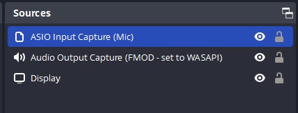

Ok! I figured it out finally, at least on my system (Win 10). Posting here as note to self in case I forget, and in case it helps anyone else :smiley:
First I set up as shown in this video:
“Audio: From REAPER to OBS - Music & Voice on separate tracks” by Tormy Van Cool
  • note, after watching that video, he has also added an video updating for later version of OBS*
The above works great for Reaper to OBS, but to make the same OBS setup work for FMOD, I had to change FMOD from ASIO to WASAPI for some reason.
And then instead of ASIO Input Capture (ie, to get the audio from the Reaper via Rearoute 1 and 2), I replaced that input with Audio Output Capture.
Note, I still kept the mic exactly as shown in the video (ie, using Asio Input Capture, set to OBS Channel 3.
Screenshots to help clarify:
3
4
5
