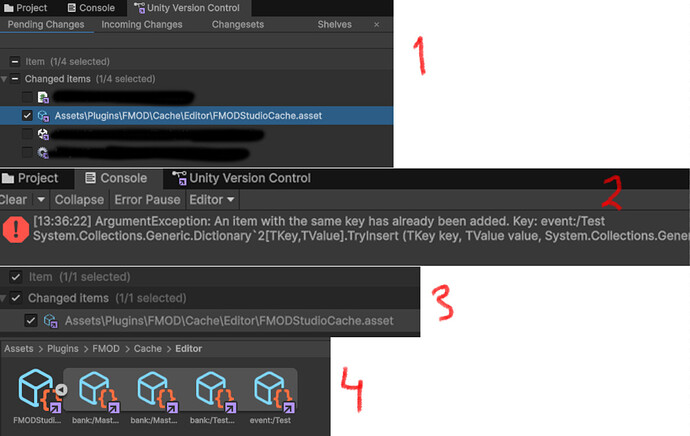

However I noticed FMODStudioCache.asset changes appearing and I’m not sure if those are “save or not” to have around, and I started to wonder if I’m missing some lines in the ignore.conf. (check 1 from image)
I didn’t first notice this in my workspace in pending changes until I updated my workspace with incoming changes that had checked in changes with it. After updating the workspace I get the following (check 2 from image).
This doesn’t seem to affect the project and when on Play mode, that doesn’t appear again on Unity’s console anymore and then it shows changes. (check 3 from image)

Based on some other posts I’m adding this following screenshot to show that there’s nothing else in the folder but these (Master bank, Master bank string, Test bank and Test event). (check 4 from image)

The entries you found are consistent with how the FMOD Unity integration is intended to be used. The Cache directory (including FMODStudioCache.asset) contains locally generated editor cache data and is not meant to be shared via version control. It is expected to change on a per-user basis and should be ignored.
Correct, If FMODStudioCache.asset was committed at any point in the past, it will continue to appear as modified until it is explicitly removed from source control. Once removed and ignored, each user can safely regenerate it locally.
This does not indicate a problem. It may trigger a refresh of local cache data, but it does not change what should or should not be committed to version control.
Based on what you’ve described, your current setup sounds correct, and no further action should be required once the cache file is no longer tracked.

I assume I didn’t remove it correctly from the source control (because of the littering). Would it still be possible to remove it even though other project members have committed it before?
Yes, even without FMODStudioCache.asset, everyone working on the Unity project should still be able to hear the updated sounds, as long as the FMOD banks themselves are built and available. The cache file is only used locally by the Unity Editor and is not required for audio playback.
Yes, it is still possible to remove FMODStudioCache.asset from source control even if it was committed previously by other team members. Once the file is no longer tracked, it can remain local-only and be regenerated per user.
