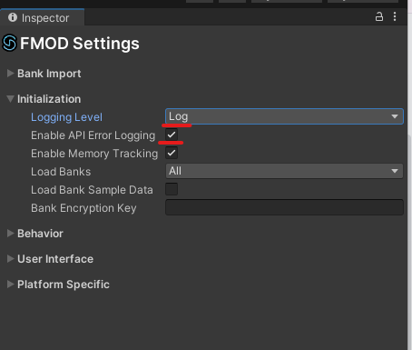

Could you please tick API Error logging and set the Logging Level to “Log” (Unity Integration | 8. Settings | 8.2 Initialization | 8.2.1 Logging Level) to see if you can get more error logs from the console?

As you metioned, we had ticked API Error logging and set the Logging Level to “Log”, but the Log looks no difference from the earlier one.

Our project is built with SDK 4.1.7.5 targeting API 11, and tested on HarmonyOS Next Beta (NEXT.0.0.26 Developer Beta 1).
The PlatformOpenHarmony.cs attached is exactly same as the one in the Plugin. So the issue persists.
Thanks and look forward forward to the development team resolving it.
